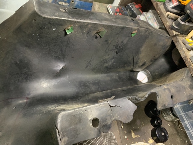

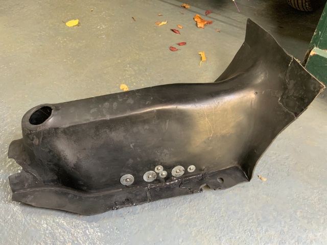

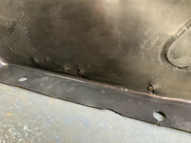

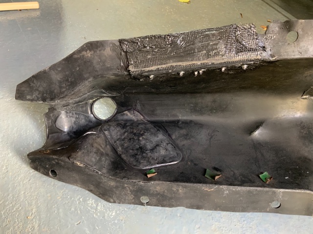

Just wondering what the low level run of 4 rivets each side of the tunnel are for ? ... They hold small square pieces of green leather in place inside the tunnel. Was something more substantial originally inside the tunnel ? What was its purpose ?? Thanks to anyone who can enlighten me!

The only thought I have is that the rivet is there to hold or locate the tunnel carpet in place. The squares of leather may just be to add some strength to the rivet through the rubber so it doesn’t pull through. What is on the outside? I’d almost expect there to be a stud of some kind, which may look like the head of a rivet. That’s my guess but look forward to hearing more educated responses! By the way, the original rubber tunnel covers are quite sought after so take of yours, it appears to be in good condition.

Ah ! That’s a good suggestion .. there are rivet heads showing through on the carpet side, but no signs of how this might have attached to the carpet .. would have been a good way to help the carpet (and or underlay) to conform to the profile of the tunnel.
The tunnel itself was in very poor condition, but have managed to save it, with a few more final repairs and reprofiling bits of work yet to do. Have followed method suggested by Chris Dancey ( stainless steel mesh bonded to the tunnel with a construction grade flexible adhesive .. in my case Black CT1 .. I swear by it for many many jobs!). For less severely damaged areas (cracks and weak areas), have been using CT1 to bond 2-mm thick rubber sheeting (with a fabric inter layer for dimensional stability) .. a bit like a gigantic inner tube repair.

My experience is that the rubber gearbox cover is screwed to the wooden floor using wood screws (round or pan head slotted) with large penny washers located over the large diameter moulded holes in the bottom flange of the cover. Then the piece of 1/2" thick latex / rubber covered sound deadening felt is placed over the rubber cover and then the gearbox piece of carpet is fitted over ditto. There would be no carpet between the floor and the gearbox rubber cover flange.

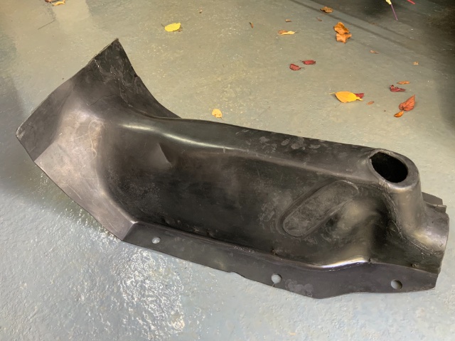

Are you sure your rubber gearbox cover is an original? I do not see any of the large diameter rubber plugs on top face to top up gearbox oil, or the plug on the side to access the gearbox dip stick.
The bits you are seeing on the underside of cover maybe from an earlier patch repair.
I have had to repair my own gearbox cover with a light sheet aluminium angle piece where the rubber was disolving at the right angle to due oil contamination.

Thanks Bill, all good points .. I had not considered that the cover might not be an original , but as you say, there are no access plugs to top up or check oil. I was planning to cut some holes for exactly these purposes, as removing the cover to check and add oil makes no sense.
Anyway, it’s now holding up well, so will cut the holes, add some sort of hole covers, and ultimately screw down as you have indicated.

Yes, I am sure the rubber gearbox cover you have is non Rover maybe for an Austin or Morris 1930's model where replicas have been made for a long number of years and possibly available before Mike Couldry marketed his. Just an idea though.
Meteor Spares ( M.c) have the correct rubber plugs for sale, they are about 3 inch dia and have a moulded groove like the originals (part No 71727) that clip/ have a snug fit over the thickness of the gearbox rubber cover. They have a moulded finger grip as well to make them easier to remove. Perhaps worth checking out and thus cut your two holes to suit the proper plugs?

I would only say that it’s a very good fit it if comes off another 1930’s make .. Perhaps it’s a 1950’s (or earlier or later) 3rd party copy of a Rover one. It’s well made though!
