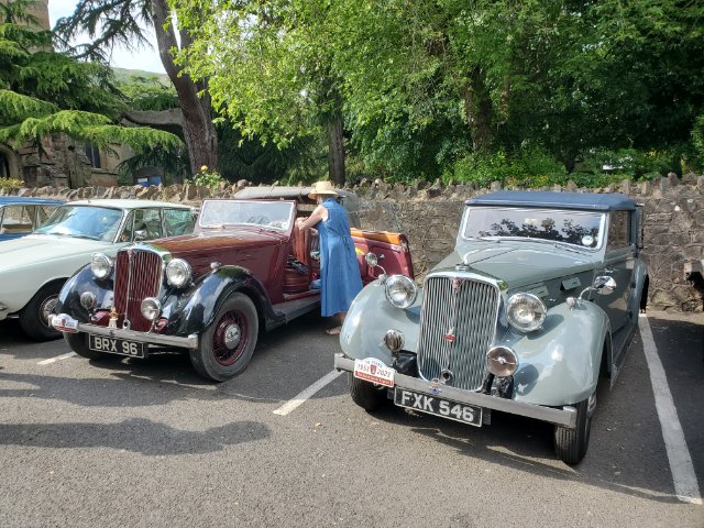

My reg is FXK 546. She may not show in official pictures on the field becasue we were late back from the hill climb and missed the judging but here she is next to Godfrey Owens 16 DHC in the hotel car park

Thanks! My wife agrees.
