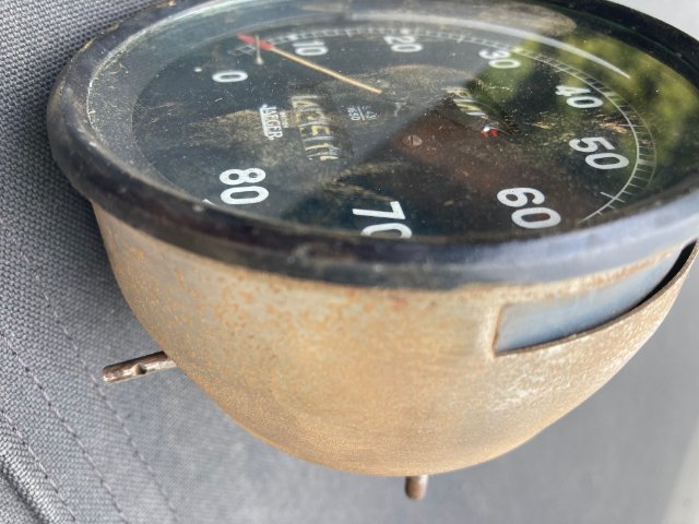

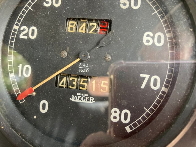

The speedometer on 110 is a British Jaeger, black bezel, marked S431/1650 with trip. I believe (hope?) it is the correct/original one. Anyone know?
- Rover speedo face.jpg (71.49 KiB) Viewed 8326 times
The trip is proving problematical. It works, but has no adjusting cable. The cable fitted in the dash went nowhere as it had the wrong end (as did the replacement).
From the instrument pointing vertically down there is a circular spindle with a cross drilled hole. This should take a sleeve with a tiny threaded pin. I found a couple of these on the Bay of E but one was too short (2,5") and the other too long (6.5"). Neither had a threaded section to locate it in the dash. The longer one could "do a job" by poking down below the dash through the soundproofing/trim.

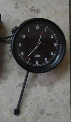

There is a special cable that connects the speedometer trip with panel. The speedometer itself is different from speedometers of previous years. The trip adjuster in the correct type is in the back and not under.

A simple solution will be using earlier type adjuster. You may cannibalize a dead clock or speedometer.

Yes. I think that is the best solution. I need to find one about 4" long so it doesn't stick down too far! What surprises me is that the correct cable will bend through 180 degrees and still work! I will then have to find a use for the redundant hole in the dash....hazard flashers perhaps.

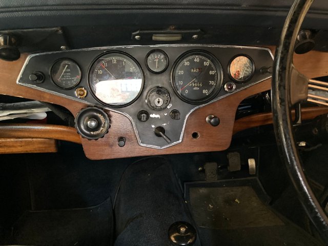

As you can see from the photo of my dash
- Dashboard 1.jpg (60.37 KiB) Viewed 8273 times
(whoops- inverted! I) have a switch doing nothing matching the trip control! I also have no heater and what would be the heater Rheostat is in fact the "Pass light" switch....not mentioned in my reprint handbook!
the oil/fuel level switch works fine. and is in the right place! The hole is where the trip cable was before I removed it.
