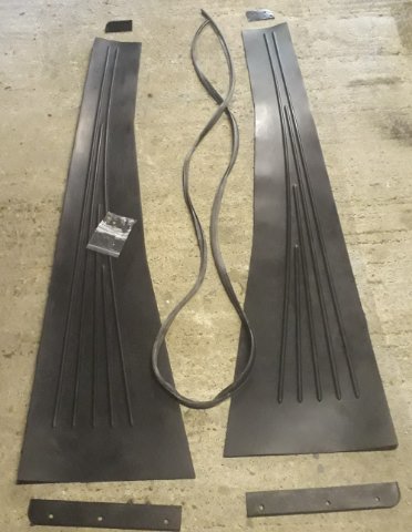

There should I think be an almost flat rubber gasket between the front wing and the stepboard which slight rounded overlap profile to the top the outer corner of which is curved to the same profile as the stepboard. See pic below showing all rubber compenents with the front gasket at the bottom. It is held in place by the fixing bolts between wing and stepboard. There is a similar gasket at the rear end of the stepboard but this is fixed to a small meatal plate and doesnt tough the rear wing which is pretty small in this location. 2 views below showing small overlap and end plate.
rubber components for stepboards.jpg (43.66 KiB) Viewed 9148 times
