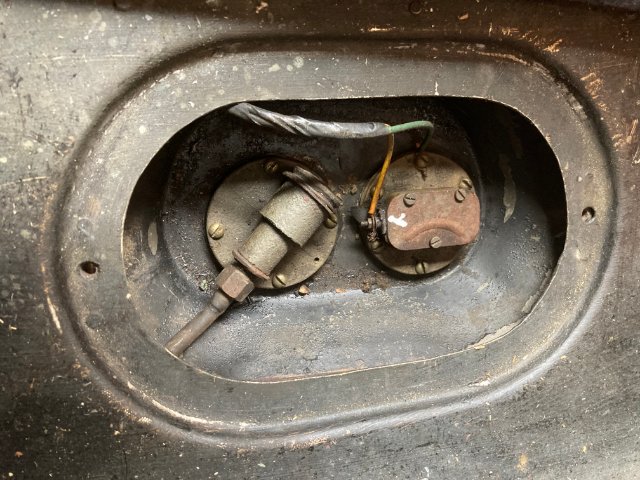

Great pictures Luli, but mine doesn't look like that! The fuel pipe assembly has no wires to it! the only wires are to the sender! I have undone all the connections/bolts etc and will drop the tank at the weekend. I have some "slosh sealant" so will try that before looking at new tanks. I have had success with it before. The only downside is having to remove the sender (and the pick up pipe, but that will let me examine it!)

Update! Tank is off & sender & feed pipes & reserve switch out. The tank has clearly suffered during its long life! :o
Sender float has been badly bodged...soldered/plastic metal on the ends flaking off. Any advice on float repair/change?
Feed pipes...where to start!
There is one long rigid plastic pipe with gauze wrapped round the end. Pipe is good enough, but the filter is a bit Heath Robinson.
The other pipe is about 0.5" long & blocked off.
Solenoid is worse The reason there are no wires to the solenoid is that the end has been blocked off & "sealed" with some sort of epoxy (poxy?) plastic metal! No idea where the wires from the switch to solenoid have gone, I will try & trace them from the dashboard switch.
Not what I wanted to find as " one of the previous owners was an aeronautical engineer!" :roll:
OK it didn't leak & it had obviously worked fine since it was done in the 90's, but...not very Rover!
I will clean, prepare & seal the tank with POR15 from Messrs Frost. I will leave the sealing efforts that I did to the outside of the tank where they are and add a bit more, they almost worked! Combined with sealing the inside it should then be ok! I may make up a simple tank stone guard to protect it.

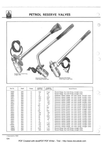

Just thought I would share this page with you. You will see there are only 4 options with the round fixing plate and it gives the lengths of the pipes for each. I will try to remember to measure mine tomorrow
It is from a 14 but it had had the same adaptation done to it presumably because the seal had failed.
Incidentally I found the replacement filter quite easy to make with copper mesh from the internet with a flat bottom wire sewed and soldered on with a flange. The top was a penny drilled twice to slide onto the pipes. Not pretty but functional and not seen!

I measured the pipes on my unit today @ 9" and 7 3/16" approx but realise that the catalogue lengths include the threaded section too ie the overall length which I didnt get. I dont want to break the seals by detaching the pipes so sorry about that but looking at the difference in pipe lengths in each type would point towards type 78000 which is 1 1/2" diff, the closest to to my difference which is 1 13/16". You may want to check my maths!
