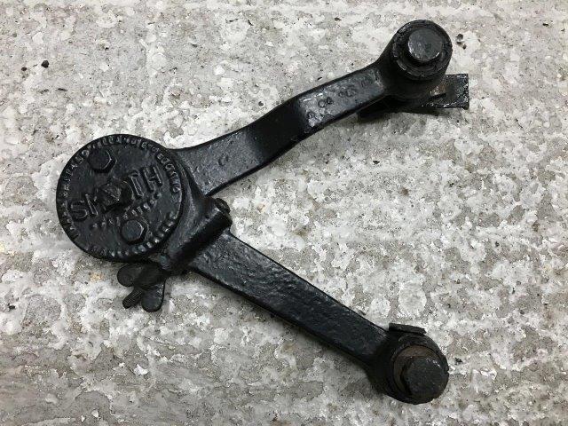

So after many years of the shock absorbers doing precisely nothing I have decided to have a look at them. Have started with the front which came off ok which is a good start. As you can see in the photos I have found a period advert which shows they are a Smith Single Acting Shock Absorber. There is also a photo of my unit that I have removed.
So has anybody overhauled there units or had them overhauled by somebody else? The shock absorbers themselves are not functioning and the bushes on the end of the arms are also very worn so will need replacing too.
Any ideas?

Hi All,
I have finally completed the overhaul of the Smith shock absorbers on the Rover and have made a short video on You Tube showing the process. Thought it might be useful to someone.
https://youtu.be/h0n1mu3KS_s
Regards, Stuart.

Hi Rob,
They work well when on the bench and have much more resistance on the rebound than on compression due to the outer band wrapping itself around the inner in one direction and opening up in the other direction. I can imaging that without lubrication the friction material would wear out very quickly while in use. I have been unable to find out what exactly the 'Absorbite' that is specified in the handbook is?? The adjusters make a big difference as you tighten them so is the end result is a big improvement on the rattly state they were in before.
