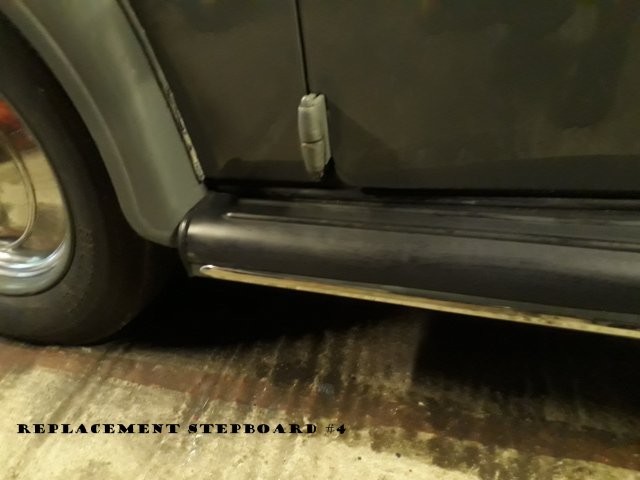

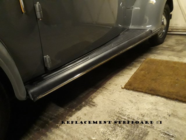

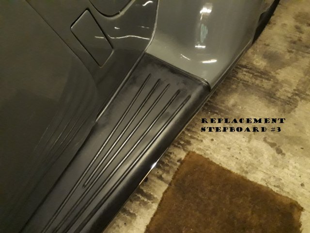

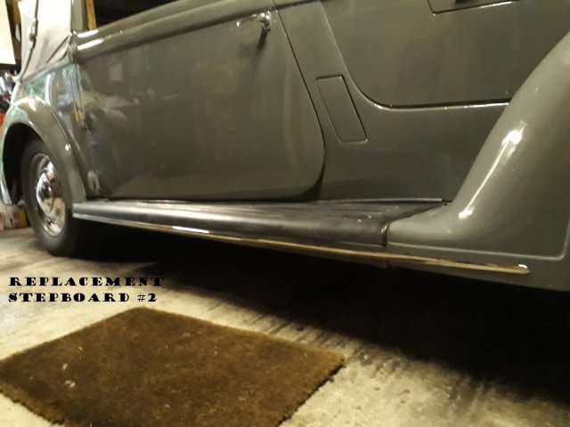

TonyG asked if I would post some pics of my stepboards and I have just finished the offside one after various interruptions and delays etc. I am pleased to get it done but I found the front wing would not align properly wth the stepboard no matter what I did. I suspect that one of the supprt brackets may be distorted or the front wing itself. So I am not totally satisfied with the end result but decided to live with it as my struggles under the car with a crow bar were doing my back in. The other thing which was outside my control was the fact that the radius of the stepboard did not match the moulded rubber lip of the cover and the rubber resisted reshaping.
Still it is now a complete stepboard with no gap to the bodywork which looks much better than before.
- 20201030_143112redux.jpg (46.56 KiB) Viewed 16882 times
- 20201030_143055redux.jpg (59.05 KiB) Viewed 16882 times
- 20201030_143039redux.jpg (53.15 KiB) Viewed 16882 times
- 20201030_143025redux.jpg (55.76 KiB) Viewed 16882 times

Thanks for posting these pictures. It’s all looking pretty good to me and seeing your lovely car is encouraging me to get on with jobs left to do to my P2 Saloon. I went through the pictures before reading your post and had to go back to them to see what you meant about alignment, so it’s probably only you who will notice it! I know that when I fitted my wings and step boards it was a matter of getting the best fit, rather than a perfect fit as a number of things have changed since the car was first built, i.e new sills, repaired wing bottoms and replaced support brackets. I found the best compromise was achieved by loosening the board support bolts and the wing bolts into the bulkhead, then bolting the step board to the wing before tightening every thing else back up. Of course, this was an easy option for me because I was fitting the wings, grill etc at the same time plus all the bolts were new and presented less of a challenge.
However, that said, one has to wonder just how well the cars were assembled in the first place? Yours was probably done with more care than mine, given that it was coach built, although that also means that the craftsmen involved had the latitude to modify slightly to get best results which is fine until a part needs replacing. Fast forward 30 years to the 1970s and I clearly recall the best school trip ever to Ford at Dagenham with Mk3 Cortinas and Mk1 Granadas on the production line. The shell with fitted doors, boot and bonnet went into a section where some guys with lengths of wood and shaped bars wrenched the opening panels about to get a good fit, which explains why a door off one never quite fitted another car! I expect Rovers were made much the same way back in 30s and 40s and I know that I’ve found some very old and curious packing pieces during my Saloon restoration. We like to think our old cars were made to high standards but they were pretty poor in many ways compared to a modern computer designed and robot built vehicle. For example, I was disappointed to discover that the drain pipe from the sunroof on my P2 runs inside the A pillar and ends within the sill, rusting the unpainted interior once the drain holes have, inevitably, blocked. Austin 1100s were the same with water from the heater inlet grill so no lessons learned in 30 years! Also, and worse still, the rubber drain pipes from the opening screen on my P2 are very short and exit into the A pillar leaving the water to run down inside and find a way out.
All modified now but the point we must all remember is that these cars were never perfect, just better than some others at the time and that’s what we are all trying for now. Your car looks great and I’m looking forward to seeing it sometime once we are allowed out to play again.
