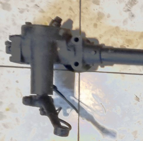

The distance - hole centre to hole centre - is 4-3/4 inches.The drop arm is curved. As for orientation - see picture.
