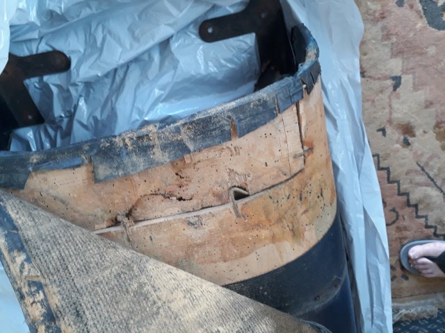

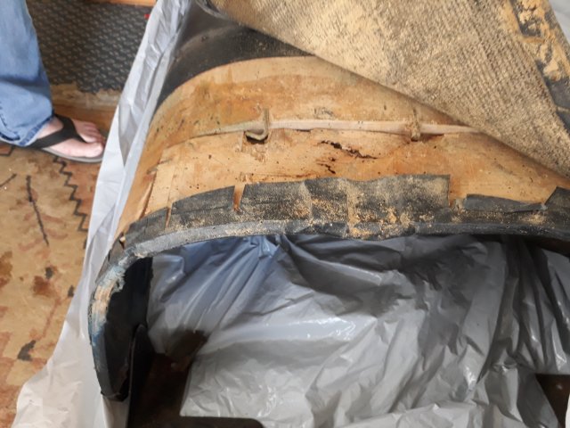

I finally bought a hide (yes a whole hide- no choice about that) and the leather worker started on reupholstering the front seats. The first was fine when opened up but the second has exposed some serious woodworm damage. Fortunately it seems to be almost confined to the very bottom of the back where it disintegrated into dust. This part seems to be a infill piece of ply about 3-4" high from the bottom - almost as if it has been patched previously. However the other seat was the same so I figure it is original. The problem is that all the ply is shaped and curved. My question is - does anyone have a template for the back of the seat or if they have refurbished this type of seat where could I get such parts?? Desperately need to know because all work has stopped and it was incredibly difficult to get it started in the first place- took about 6 months after I accepted the price!
I will try and upload a couple of pictures

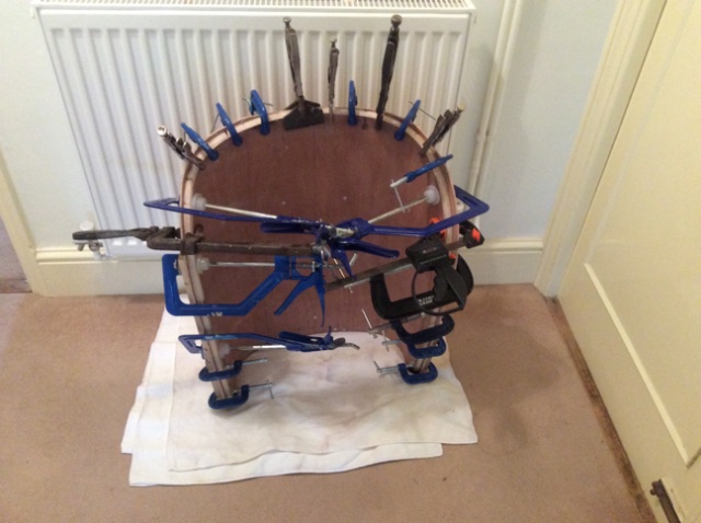

I had exactly the same problem as you when I went to get the seats in my Tourer re-upholstered. That was six years ago and I was unable to find any old seats then. I contacted various companies who undertake plywood steam shaping, but none were interested in creating a mould to do just two. The first thing I did was make a 'buck' to bend plywood around. I thought that using a number of thin sheets might work, gluing them together as I went and creating a steam tent using a wallpaper steamer. Needless to say, it didn't work and the sheets of ply simply went straight again when I removed all the clamps. Ironic that ply always bends when you don't want it to, but no chance when you do!
I also looked on line and around local furniture stores/charity shops to see if there were any 'tub' chairs that I could repurpose for my car. No luck there but I mention it as an idea worth following up, hopefully with more success.

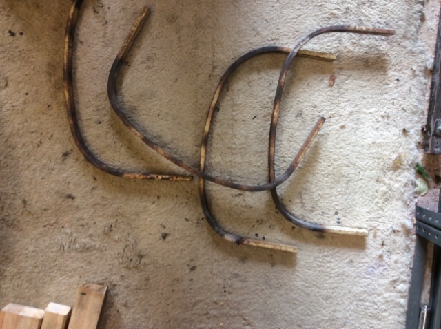

In desperation, I got working with a blow lamp and some thick steel bar. I bent up four curved pieces of steel (the shape the seat back needed to be) and then used two for each seat and welded three uprights between them to create a sort of half basket arrangement. Then I took some thin ply, cut to the correct shape of the seat back, and riveted it to the inside of the steel basket. On the outside I cut pieces of softwood and shaped the edges so I could stick them to the ply on the steel frame side creating a kind of barrel. Once the glue had hardened, this was smoothed off and another sheet of ply was glued to the outside and clamped together. Once dry, the seat was shaped and the back was ready to cover. Instead of the original hinges, I used the ends of the bottom curve of steel bar, bolted through to some strong brackets on the newly made seat bases.
It sounds highly involved and difficult to convey in a post, but all the above happened in less than a week as I had to provide my upholsterer with two seats to cover within a tight time frame. On reflection, It may have been possible to fabricate the seat backs from fibre glass or from sheet steel curved and reinforced around the edges, like a section of a steel oil drum.

Hope that helps a bit. To be honest, it was one of the most challenging aspects of my car restoration.

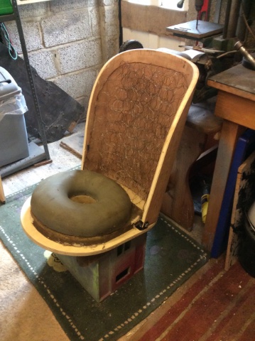

I used the old seat itself as a mold. Worked pretty well.

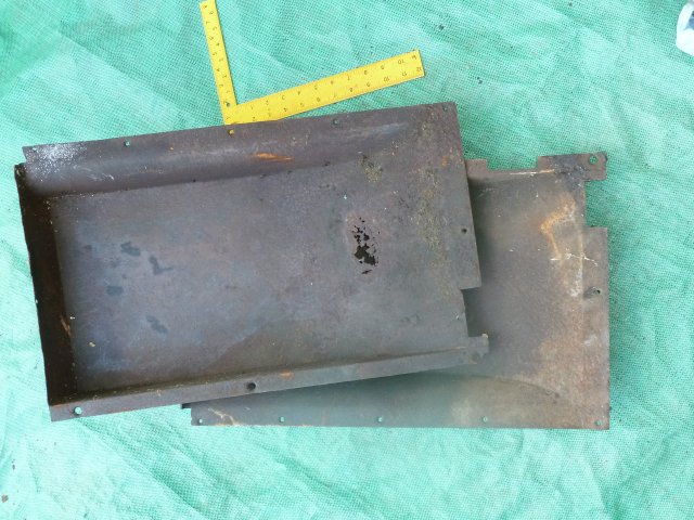

Mine is a 39 DHC 14 so definitely different form the tourers. Picture of the footwell trays in my spares attached - a bit lacy but mostly sound. My hesitation is just that after repairing them and fitting them the carpet wont fit any more and I am not quite ready to replace all the floor carpets

Good to have them in stock and ready to go when the time comes. From the picture they look very similar to the ones I removed from my ‘P1’ Tourer, although not the same. I assume the deep section sits at the rear of the car, like mine do, but the curved profile at the side top of yours suggests they are made to follow the curve of the outer floor board. That said, does your car have ash floor boards or was that a P1 only feature? While my floor has the curved edges, the foot wells sit below inside the chassis on the outside, supported by the tunnel in the middle. A good use of space to create leg room but a fussy arrangement with regards to construction, carpeting etc and bad for collecting water, which has no means of escape. Yours are a better design but a flat floor, like the P2 saloons, is better if there is enough rear passenger leg space.
