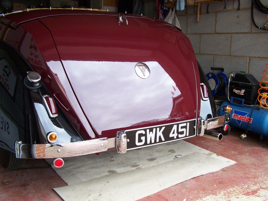

Hello Nigel,
I have a 47 tourer, it was restored by the previous owner and many things were left unfinished or done poorly.
I will be removing the autolube and putting in grease nipples at some stage as some areas are not connected. I need to find out the size and thread needed for the nipples then I will remove the whole system.
I have done some improvements including removing the horrible indicator lamps front and rear (which were a total bodge) and rebuilding the back bumper and lighting (another bodge).
In hind sight I should have looked at the car instead of relying on a car salesman and pictures.

Hi Gerry,
Your car looks lovely with only a few things to do! Wish I could say that about mine! I have a few tasks before I'm happy with mine. I would be very interested in your autolube system. Basically most of my pipework is intact right up to the bulkhead where it should join the reservoir. The reservoir and it's parts have all been stripped out. For sizes of thread see the article by Chris Dancey in the June issue of "freewheel" may be of use along with a forum topic on the subject. So please do let me know when it's available and what parts you have. As I have (I think) all of the pipework out to the lube points it's the reservoir and above that I'm interested in.
