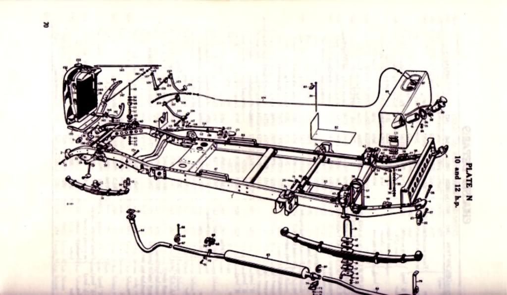

Hi
I looking for a dimension drawing/blueprint of a P2 (12) chassis. I'm looking to build a special and would like to compare it to other similar chassis's.
Any help greatly appreciated.

Post by GOY189 » Sat Dec 25, 2010 4:30 pm
See the attached for a general view
The following is from James Taylor's book:-
wheelbase 105 inches 1934-1936, 112 inches 1937-1947 and all 6 light saloons 1935-1947. Front track 50 inches, rear track 51.5 inches (34-39) 54 inches (40-47. Length 156 inches - (34-36 sports saloons), 160 inches 35-36 saloons, 161inches (34-36 tourer), 169.5inches (37-47). Width 62inches (37-47), height 63 inches (37-47 saloon), 61 inches (37-47 sports saloon). Ground clearance 6.5 inches, (5.5 inches 34-36 sports saloon)

Post by Spyder » Tue Jan 04, 2011 9:35 pm
Thanks chaps for the information. I've got the drawing you've posted Mike. I've began modelling on CAD the 12 chassis I've already got. It's just to give me some help/guidance on the special I'm attempting to build.
