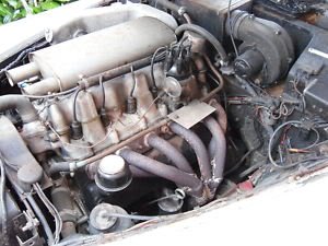

Engine bay, showing 6 port exhaust manifold.

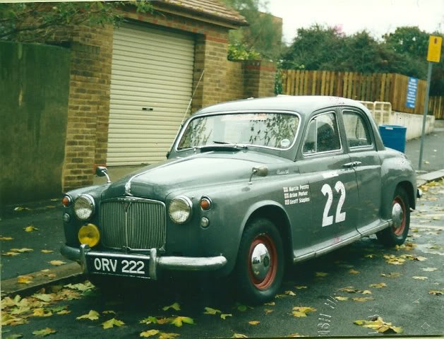

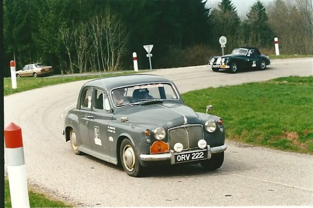

Picture taken mid-90s showing extra spot-lights and hi-intensity headlights, this rally number was for participation in the 1995 Monte carlo Rally, by the time it competed the large yellow spot had been replaced with a pair of Cibie spots which it stll carries today. The tyres are special radial snow-tyres.

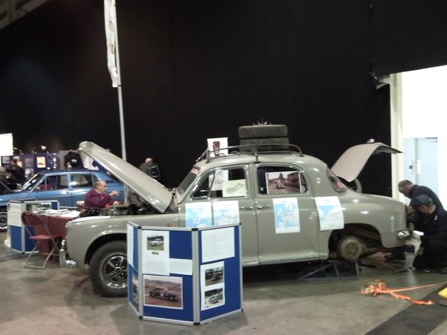

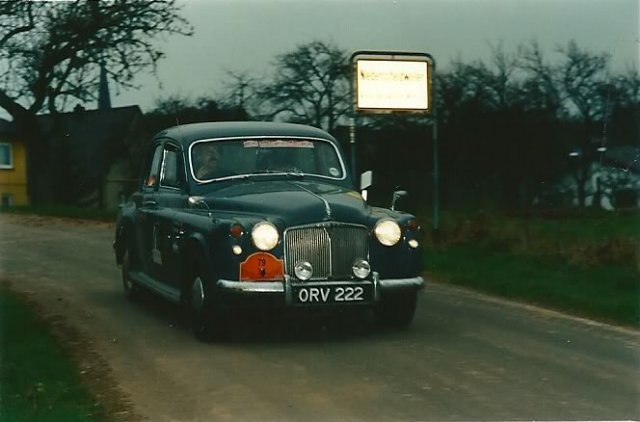

This is the car on the RSR stand at Stoneleigh, October 2011. It shows the original roofrack that was with the car and a pair of radial snow-tyres on the roof. Serious looks at the lack of metal where the body should be.
First task is to get it through an MOT, which will mean fabricating some body mounts, which will entail removing the enlarged petrol tank (uses all the spare wheel space), rear valences and part of the rear inner wings to make new bits.

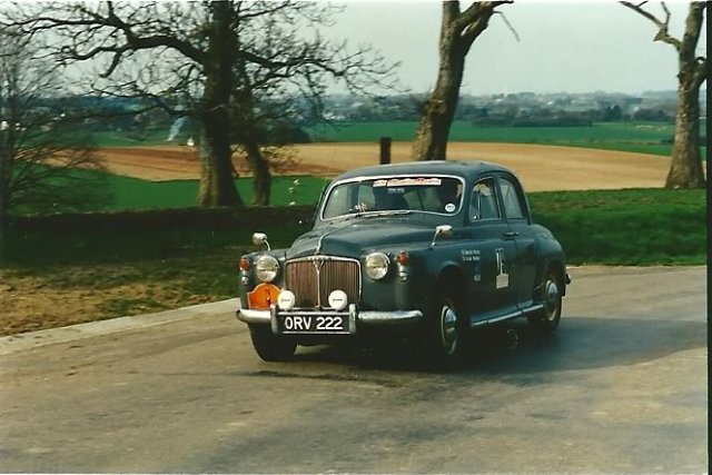

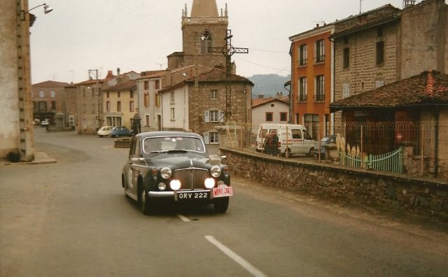

The following are some of the car's rallys and results I have been able to find.

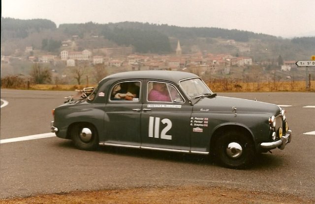

car no.112 OA postion 54 Class Position 6

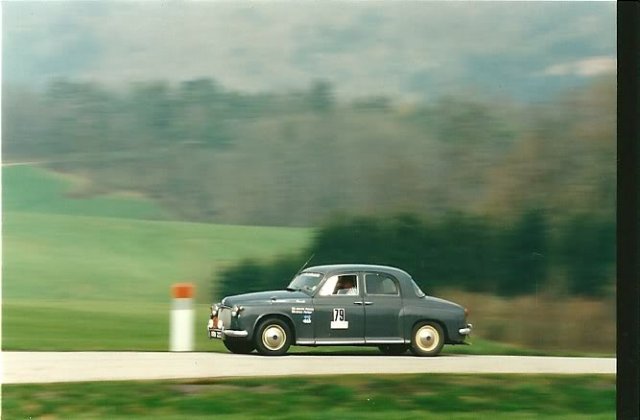

car no. 79 Position 43
