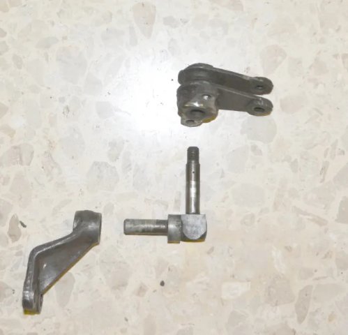

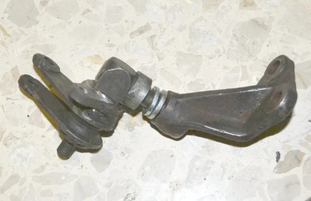

The rod brakes system is designed for the leaf springs and the rigid axles. The distance between the axles changes with the load on the car. The purpose of the telescopic segment is to make this distance increase without applying the brakes or decrease without distorting the rods. Therefor some distance must be kept between the two halves of main rod, resulting in some free travel of the brake pedal, This distance should be adjusted so that the free travel of the pedal would be ~1”.
Also, on non flat surface, one wheel will be higher than the other, resulting in an angle between the chasis and the axle. This why the rear compensator is mounted on a pin and can turn as necessary. The front compensator has a similar arrangement.
