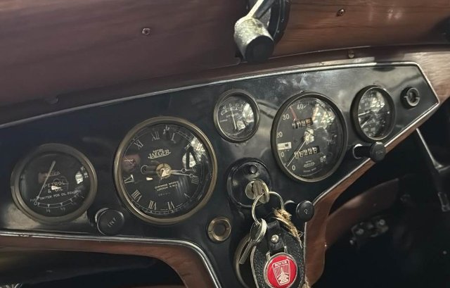

1. Was the lettering on the dashboard knobs (e.g. Mixture and Throttle) originally in white?
2. If so does anybody have any tips on how to try to restore such (i.e. hand painting etc)?

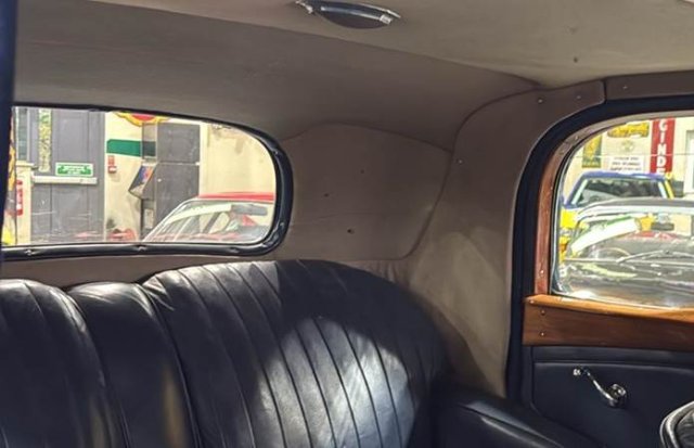

3. Any tips for dealing with moth holes in the rear compartment quarter panels of the headlining?

The Dashboard lettering is white paint. Try using a round tipped fine hypodermic needle to fill the letters.
The headlining is union cloth. You might try wool felting-see https://www.youtube.com/watch?v=7vBODmr_TZE

I have had a go at refreshing the lettering on the knobs using white acrylic paint and then polishing back the paint using a magic eraser to remove any excess and give a slightly worn appearance.
Thnaks for the tip on the felting method, but might be a bit of a challenge trying that with the headlining insitu but worth a go.
