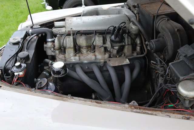

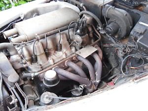

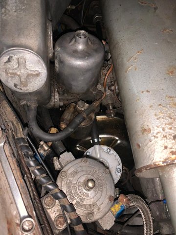

Engine bay, showing 6 port exhaust manifold.

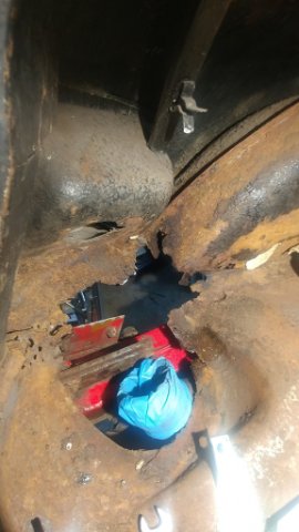

Upon inspection the condition of the car became apparent, the chassis was OK as expected, but the rear body mountings had suffered from rust. It was however an interesting car and I decided to do my best to rescue it.

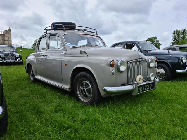

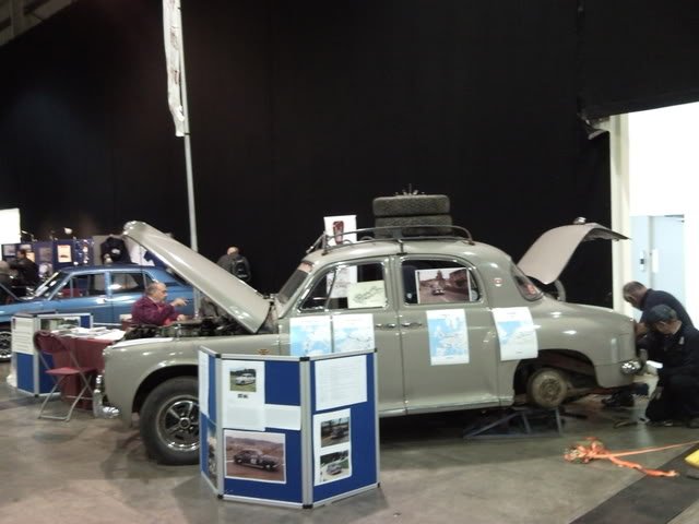

This is the car on the RSR stand at Stoneleigh, October 2011. It shows the original roofrack that was with the car and a pair of radial snow-tyres on the roof. Serious looks at the lack of metal where the body should be.
First task is to get it through an MOT, which will mean fabricating some body mounts, which will entail removing the enlarged petrol tank (uses all the spare wheel space), rear valences and part of the rear inner wings to make new bits.

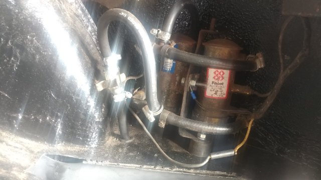

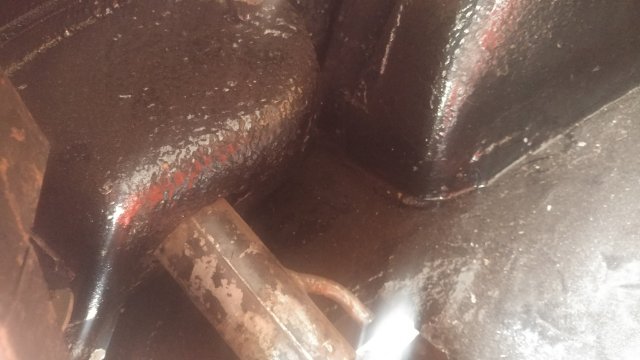

I replaced the rear body mountings, removed the valences and spare wheel flap and repaired the boot floor and inner wheel arches. The car had been fitted with twin rally perol pumps which I also refitted, they were working fine, but the petrol reserve solenoid was not working and the breather pipe had become detached from the tank, so I decided to remove the petrol tank.
twin pumps.jpg (48.03 KiB) Viewed 40939 times

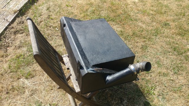

On this rally car the tank has been modified for extra capacity so it now uses up the space where the spare wheel was, this about doubles the petrol storage. I dropped the tank, brazed on a new vent pipe and also took apart the solenoid valve. A simple repair soon had this working as normal. Replacing the tank, and its extra guard underneath was a little tricky, the worst bit being replacing the filler hose and breather pipe through the boot.
Repaired tank, showing the extra capacity, repaired breather

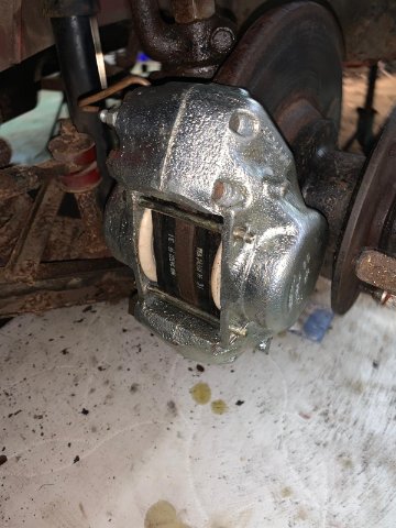

The next attention was the brakes, they would lock on when used, inspection showed some well worn front calipers so as I had a new (refurbished) pair these were replaced with new pads and a new Girling servo added along with a new set of seals for the rear brakes. After fitting and bleeding the system was fine and the car now has some of the best brakes I have ever had on a P4.
New Girling Servo hiding under pressure reducer/filter
New caliper and pads (both sides)
Attention was now needed at the front of the car, expecting to have to travel through hot climes, the radiator was taken out and recored with a modern tri-core (3 rows of cooling tubes) and an electric pusher fan was added, the fan being removed, a new 80 degree thermostat and new hoses added. The engine will now run happily without the fan cutting in and when run with restricted air flow, simulated by blocking the grill, the fan keeps the temp in range.
engine and new radiator and fan.jpg (60.91 KiB) Viewed 40941 times
Special 6 port exhaust manifold and new radiator and thermostat
The exhaust was next for treatment, the existing one was held togther with patches and exhaust paste so to benefit the 6 port exhaust manifold fitted I build a 3 inch cherry bomb exhaust using parts from Rover 110 exhausts, this fits neatly into the chassis and gives a unobstructed clearance under the car.

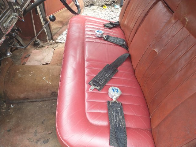

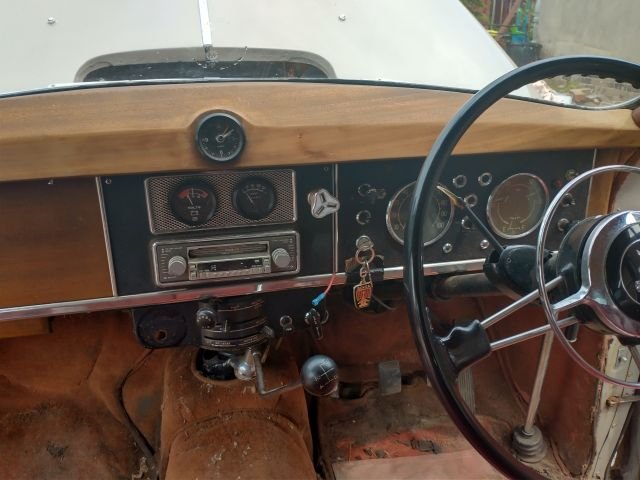

Front bench seat, showing new leather upholstery on seat and rally lap belts.
Dashboard showing extra instruments, voltmeter and electric temperature guage

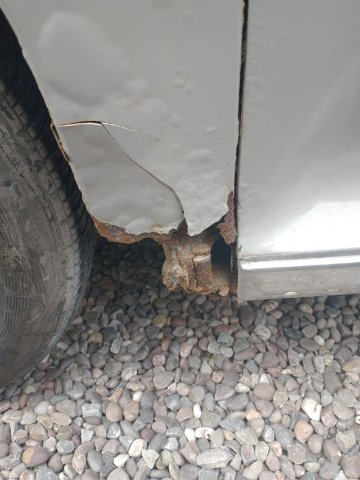

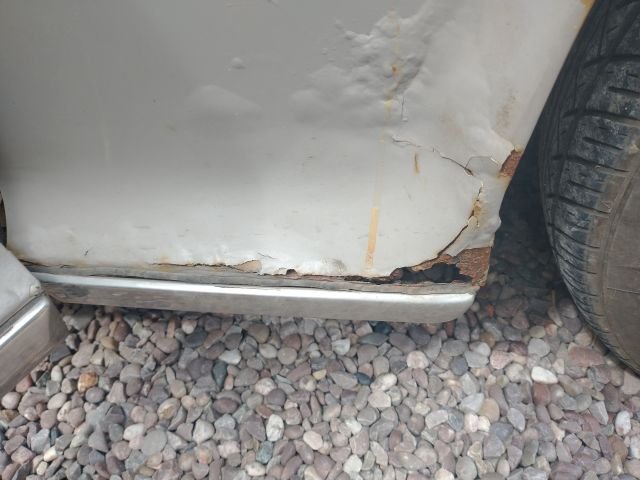

D post offside.jpg (51.23 KiB) Viewed 40783 times

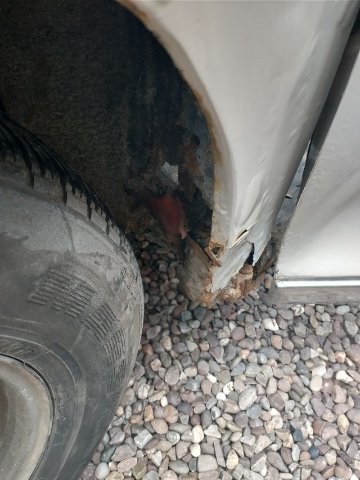

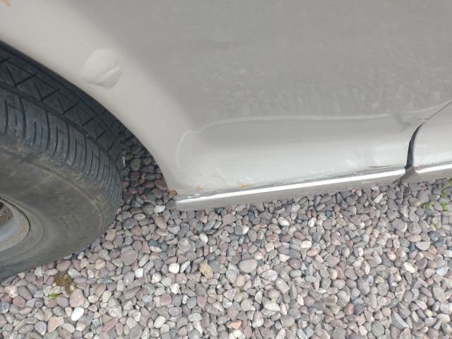

worst bit of body work, D post exposing lower hinge and also inner arch needs repair
Dpost view 2.jpg (57.27 KiB) Viewed 40783 times
D post area near side.jpg (83.04 KiB) Viewed 40783 times

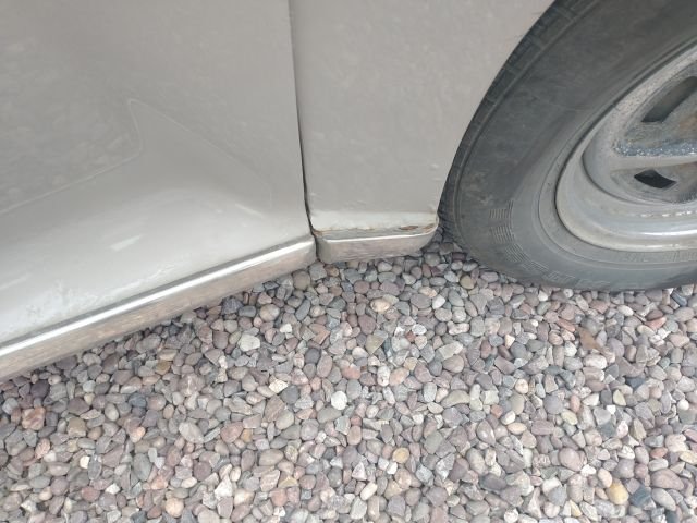

Near side is better but some repair is needed to wheel arch section.
