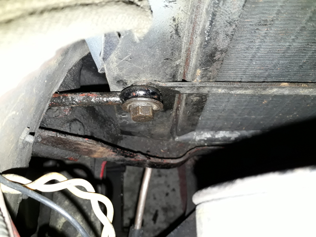

With regard to the tie bar across the back of the radiator between the 2 wings this is also anchored/bolted to the radiator housing (see photo which shows one end of flat bar across rad and the eye of nearside adjuster bolt) so tightening up one side shouldnt raise the other wing UNLESS the radiator housing moves also. I shall have to check that bit myself but it was such a struggle to get all the bolts into place (I had the radiator surround off to relocate the copper fuel supply pipe around the bottom without joints and refitted the missing baffle plate) that I dont want to look at it again right now. I will have to because I could not get the bonnet leaves with even gaps afterwards as the radiator housing does seem to be out of square now!

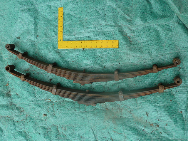

I have found that I have 2 leaf springs with my spares but no information on them. Can anyone tell me how to tell the difference between front and back, left and right springs- if they are the correct 39 Rover type? Picture attached
Leaf Springs unkown provenance

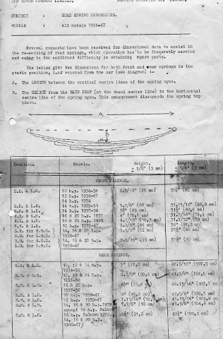

Having dug a bit more I ahve found the page of spring dimensions - attached. I am flabbergasted by the number of different dimensions. Why on earth were they not rationalised abit?

Both springs in the photo are front springs. The wedge at the bottom controls the castor, the center bolt points down, the two bushes are of the same size. (one is missing) The short part should be at the front.
Yes, tightening and adding washers may help but not necessarily if the pin, bush and shackles are worn.
