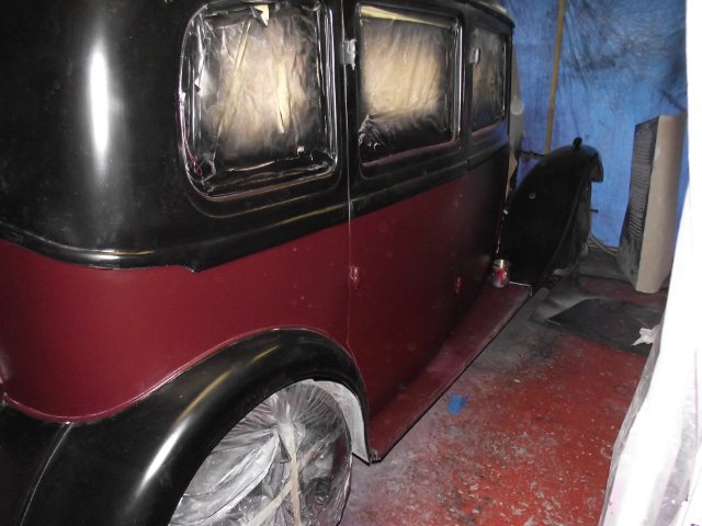

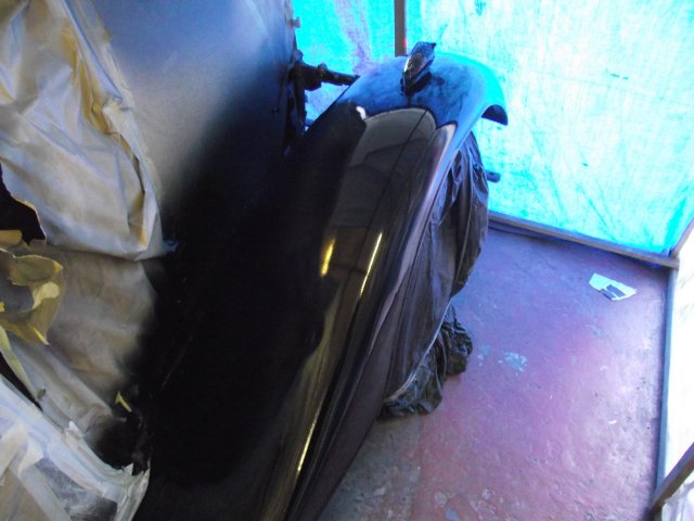

Thanks to all for the useful advice I am in the middle of spraying the car ,but once done thats one of the next jobs to do .I mentioned a while ago that I built a "TENT" in the garage to save dust settling also to save paint overspray getting all over the garage Ive sprayed several cars without a TENT and find there is always dust and overspray problems I have masked the car off except for the front wings which I am spraying separately,as to do all the car in one go risks touching wet paint as you move around spraying it. Had a problem having maroon paint mixed as there is no longer a specific maroon dye.However our local paint supplier is more than helpful and mixed paint,to the shade I wanted Attached is a photo of the one wing,the colour on the front is a reflection ,of the plastic "TENT" covering the other photo is the car nearly ready for the lacquer coats.Len
