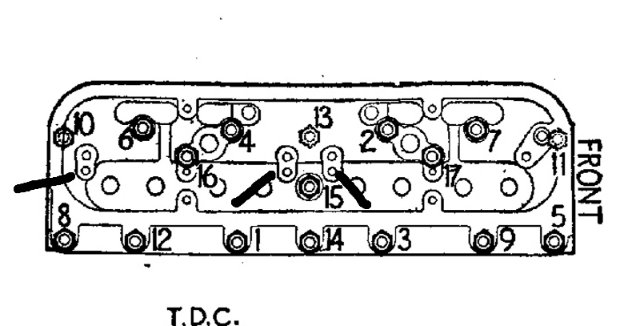

Post by luli » Sat Feb 05, 2022 4:58 pm
Look at the attached picture. The marked rocker shaft holders are slotted and clamp the shaft by the the nuts on the top of the studs. Release the nuts and open the slots using a screw driver or a chisel and than you will be able to turn the shaft. see also here: https://lulis.org/2013/04/26/%d7%a9%d7% ... %d7%a8-10/
