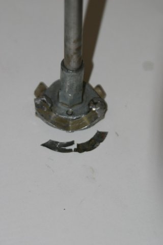

Just as an addendum to this posting, I have managed to repair the trafficator on my 12 tourer, the construction is slightly different to the one discussed above, the internals are as per Luli's photographs but mine is a one piece stalk and bottom bit unlike the later ones that have a screw to connect the bottom to the stalk. Whilst driving and indicating the little pin and wheel that centre the trafficator fell apart and locked the steering mid corner, slightly alarming I have to say, no further efforts on indicating were made for the rest of the journey. It transpired that the metal strip that the centring pin runs on disintegrated and caused the problem. I did manage to manufacture a new piece of metal and solder it to the remainder of the original, quite pleased with myself I have to admit
