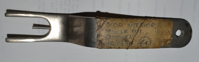

Starting work on our car.
How do you get the inner door lock handles off? The ones on the inside of the door.

Actually found it. You need to push back the spring loaded fertile and there's a pin holding the handle on.

Post by luli » Mon Apr 10, 2023 12:00 am
There is even a special tool for doing that:
