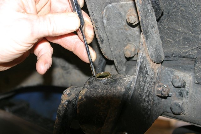

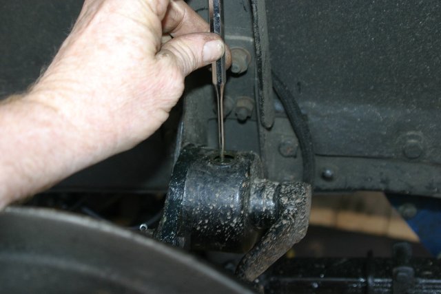

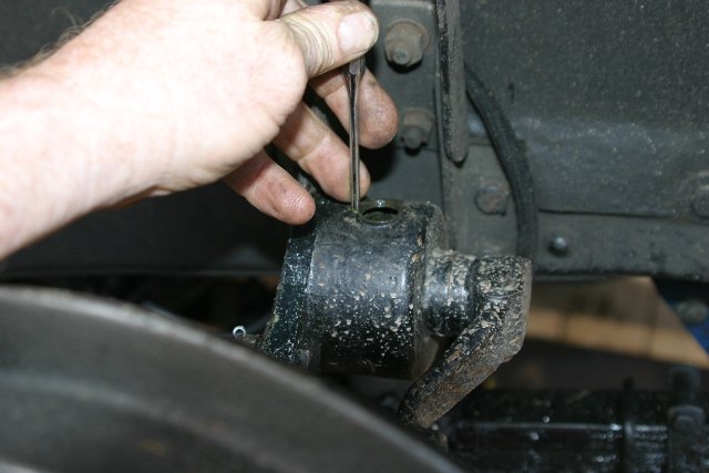

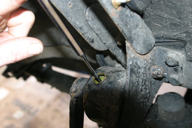

I have made a few photo's of both suspension units with a pin showing the depth available, to go any deeper one has to go at an acute angle and sort of guess the oil level, certainly not an exact science.
first the N/Side, the maximum depth possible is about 1/2",
the O/side is different, the depth available is 1/8" and the screw on to is more a small bolt with a screw slot , flanked by to wires under tension effectively creating a locking mechanism, I have put about 40cc of oil in as I couldn't get any on my pin at an angle.
I think I will have to take the units off at some point this summer and check that the drop speed is the same, I can then also empty the oil out and re-fill with new 140.
