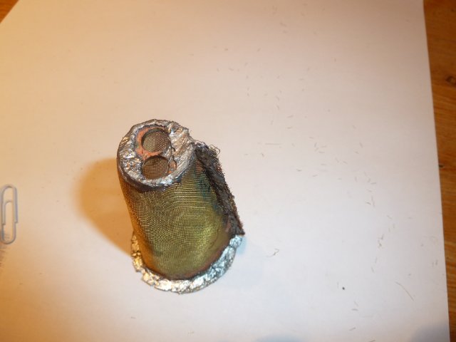

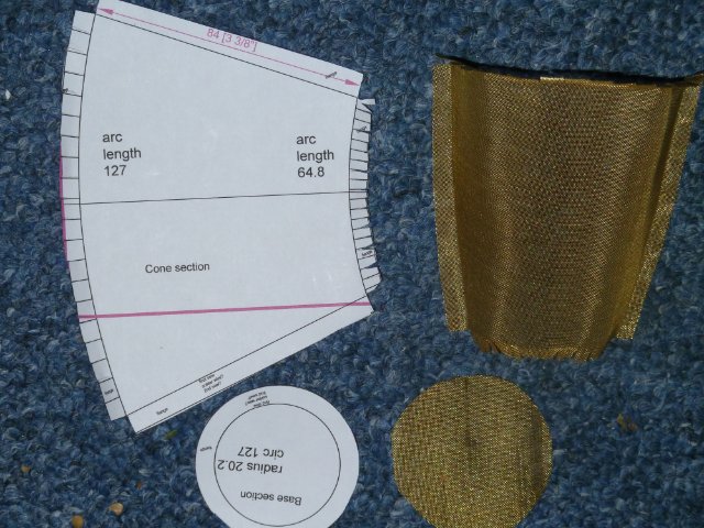

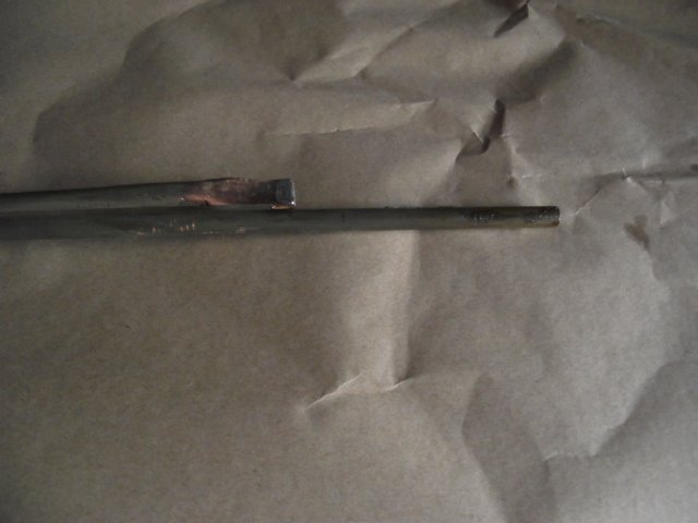

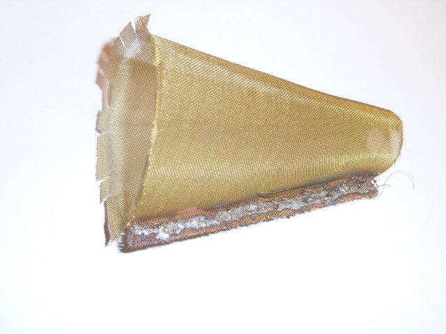

If its any help here are the components from when I made a replacement dip pipe filter for my P2 using some brass mesh. The theory was right but my soldering skills are appalling. The top of the filter was drilled from an old penny as you will see. It is a tight fit through the hole into the tank and it is difficult to solder the filter rigidly onto the dip pipes, so needs installing gently so as not to have it drop into the tank. I am sure someone could suggest a more secure method of fixing

Hello thanks for the drawings .Without removing the feed pipe again,can you tell me the diameter of the long pickup pipe and the diameter of the hole the pick up assembly it screws into Len

My second reserve tank unit is off the car at present waiting for me to replace the ball bearing which doesnt seal too well so I have been able to measure it. The dip pipes are 7mm OD. The slight shoulder on the reserve unit body which just sits into the hole in the tank is 47.2 dia but I suspect the actual aperture in the tank may be sa fraction more. Hope this helps
