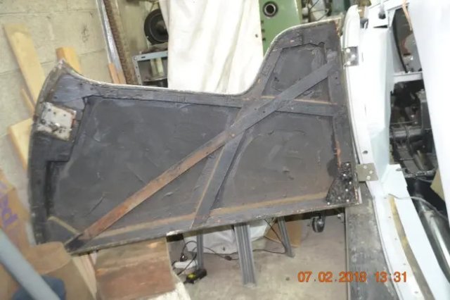

Sorry to hear that, Rob. I wish you could have used Tino's services....
- delet.jpg (45.98 KiB) Viewed 13381 times

Thanks for that Luli
It is interesting to see the structure of the door exposed although the tourer is a different shape to the DHC. I have never opened mine up but dont think it has the diagonal metal stay and corner plate. Is that original or Tino's repair?
Did you have a problem getting the correct curve where the bottom of the leading edge curves into the body? I am guessing the frame was originally steamed into shape but mine had straightened slightly over the years so the bottom corner no longer truly met the body opening. It was quite draughty and indeed wet at times!

Hi Rob,
It is original, and the metal is Aluminum, Which was corroded. Tino has both the equipment and the skills to deal with wood and metals. He replaced the corroded metal and welded it, and adjusted the doors to fit their space and the body lines, verifying that the sound of shunting them is nice. The frame of the doors is all wood - no metal. Later Daphna and Alon finished it, rebuilding the sophisticated stopper.
See here: https://lulis.org/2018/10/01/51-%d7%92% ... %95%d7%9f/

The diagonal strip is what pulls the bottom front part of the door in, so that there is no gap (often a problem on suicide doors). It can be tightened to pull the door in by moving the screws, or as I did on one car, by making the strip into a pair of brackets and joining them with a short length of allthread with lock nuts so that could be used like a rigging screw to adjust the set of the door. I saw that system on a Jaguar XK120 Coupe door. Quite a lot of effort can be needed to get the door back into its correct place and the “rigging screw “ method is relatively easy to apply that force. It can be done single handed.

Thanks David and Luli
I did wonder whether the diagonal on the tourer was meant to hold the curve to the bottom of the leading edge of the door. To encourage the frame to curve I think that not only would the metal need to be bent but also have a fulcrum behind it to make the wood frame conform also? Or maybe a t-bar (rebated around the timber) would be stronger?
My DHC definitely does not have any metal work that I can see but maybe I should suggest to the (eventual) bodyshop that this is needed. I guess the flat plate may need letting in to the woodframe also... I can see I am going to struggle with this
