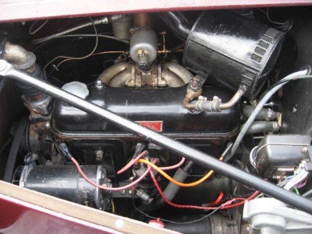

Hi Folks I am just putting my 1947 Rover 12 Tourer back together from when I dismantled it 35 years ago. Unsurprising that I am at a loss as to where the heater water pipes go !!!!!! If anyone can supply photo's of their cars engine compartment showing all the water pipes it would be much appreciated
There is a rear end cover for cylinder head with a threaded elbow on. Also a threaded fitting in the top of the water pump. Where do these go to ?
Many thanks for your comments & photo's Bob Forrest

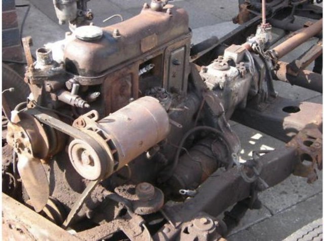

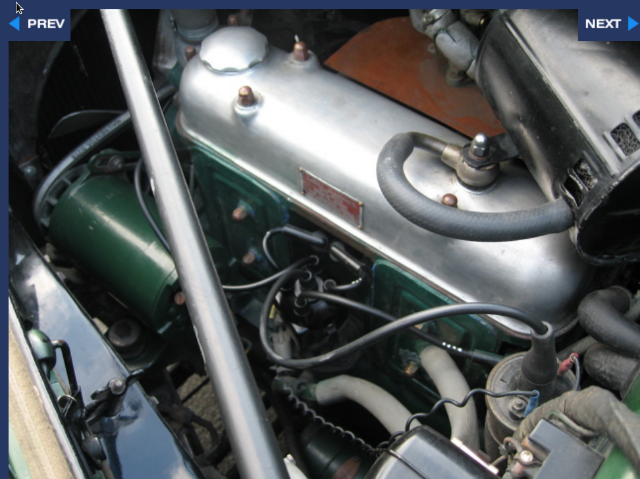

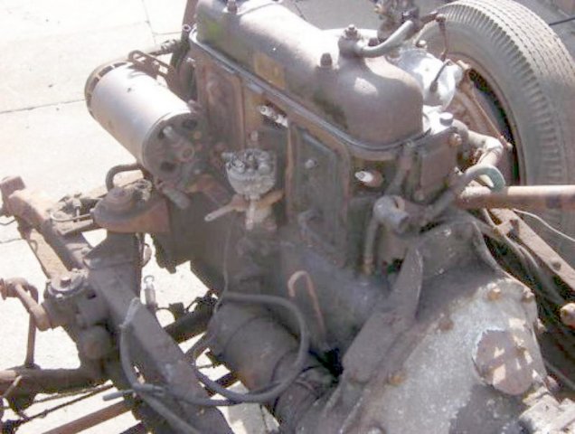

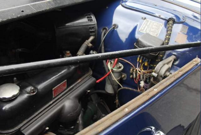

It is absent on my tourer #63

Thanks Luli, helpful pictures.

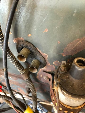

Looking at my bulkhead there is a small oval plate (big enough for a couple of pipes. Which presumably could fit into a double grommet like on Minis or possibly there are two holes/ grommets) in the appropriate place....and another , smaller round one some distance further down (unknown purpose!). No sign of the three mounting holes yet...I will keep looking) I haven't taken the plate off yet to see what is/are shape the hole(s)
It is fitted by a couple of 2BA size slotted round head screws. Not sure if a self tapper (unlikely if original build) or with a nut inside the car. More standing on my head under the dash to see what is behind the carpets etc!

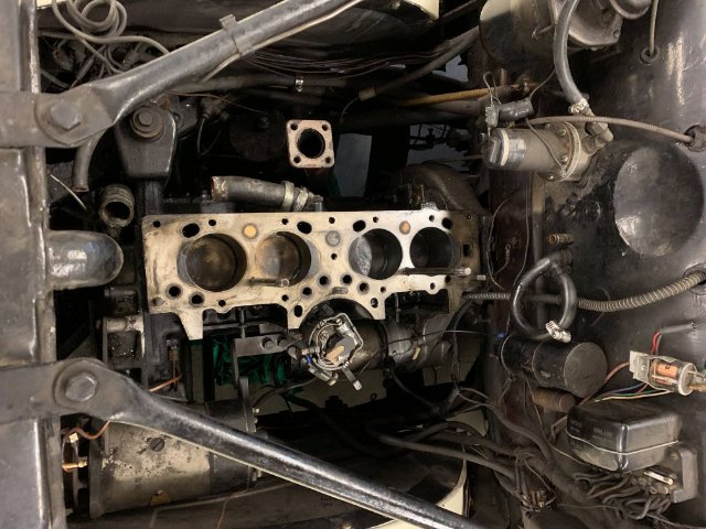

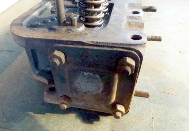

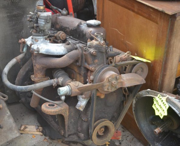

Some pre heater head back cover
1946 engine with improvised heater:
