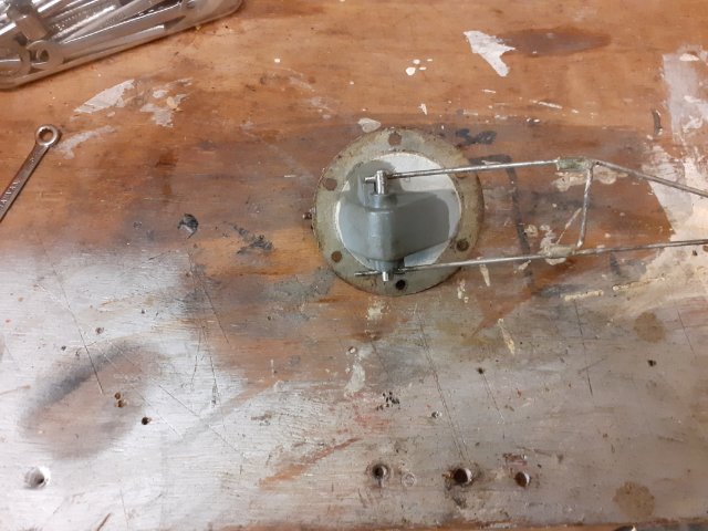

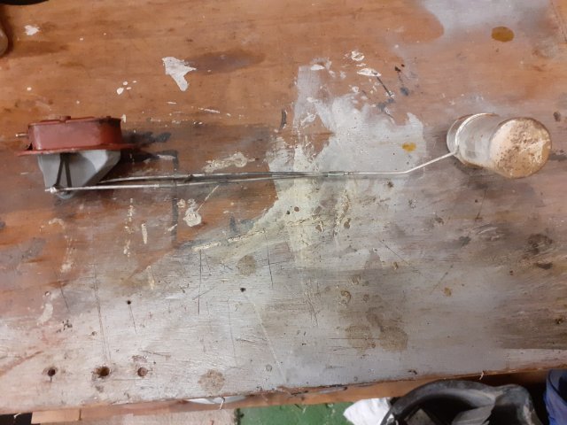

Famous last words! Went down to just under half then stuck again, Released for 4th time yesterday and now immediately functioning again, showing 3/4 tank. I'm bamboozled by this. Once freed it operates perfectly smoothly, but once stuck, it's properly stuck and takes a real 'snap' to initially release. Can't have been like this it's entire life..........attached pictures, is it original? Looked at mini ones which look the same, may see if one fits.

I feel it might be time to replace
Re: Petrol Tank sender unit
Post by RobHomewood » Thu Sep 22, 2022 10:59 am
This sender type is available from Holden and maybe others. It is quite easy to change the float if you wish to keep the metal one (new ones are plastic). You may find that only one side of the yoke is connected on the new unit but it doesn't seem to matter. There are two types listed- one for top and one for side entry but I found these identical, only differing in the orientation the float is fitted. In fact when fitting both oil and water units at the same time recently I fitted them the wrong way round to no ill effect!
Post by RobHomewood » Thu Sep 22, 2022 11:00 am
sorry typo - not 'water' unit but 'fuel' unit of course

Thanks. 'Minimine' here in Stoke on Trent have classic mini ones which look the same on their website. I'll wait until it inevitably sticks again and take it there to check the spacings of the 6 bolts are the same. All being well they're only £20, so I'll let you know.
