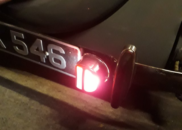

You are perhaps right to have concerns about the rear indicator being a red lamp in the rear cluster. I really didnt want to change the appearance of my car by adding new indicator fittings. I changed all my bulbs to LED's so that I now have dual LED's in the front sidelight fitting giving a white sidelight and flashing amber indicator from the same bulb. I have changed the semaphore to LED festoon bulbs and the rear indicator to a flashing red LED in the original cluster. Initially this was because the 80 year old wiring was in a desperate state and I wasnt ready to re wire. These LED's take a small fraction of the current that the filament bulbs do but make no visible change. The other advantage is that they are brighter. However the issue with the rear indicator remains and I think this is mainly becasue of the position of the light- it is low down and toward the centre of the car, very close to the brake light and people dont expect that. Nevertheless I feel relatively happy that I am visible but may change again if I find even brighter bulbs.
What I do miss, especially when crawling slowly up hills is hazard flashers but I haven't worked out how to do that yet- and still keep the semaphores

Yes there are some long steep hills on the A30 for instance where modern cars are almost all at 70mph plus over 3 lanes of traffic. I agree I probably wouldnt use the hazards unless I thought I was going to actually stop and that I suppose is when I would need them most. To date despite the engine still not giving full power I feel, I have managed to get up that hill without dropping much below 20mph as I can get a run at it but some of the country lanes (often called A roads down here) can be pretty demanding.
Having just rewired the front end of the car the semaphores are the only kit which is still operating on the original wiring and that is because to replace it I would have to dismantle the rear armrests and side panels which looks likely to cause collateral damage. Maybe next year!
Out of interest I was going to add a video of the lamps working but it was too large so here is a still

They look bright. Where did you get the LEDs from? I need new bulbs for the semaphores on my Tourer so may as well get some for those. Were they a direct replacement? Re the wiring to your semaphores; if you can find the end under the rear seat or wherever it heads off behind the side trim and at the trafficator end, if it’s not fixed, you may find it’s possible to ‘cut and draw’ a new wire through by joining the old to the new and making either a tight taped joint or using heat shrink wrap, thereby avoiding taking the trim off. Just a thought.

I got all my LED bulbs from the Classic Dynamo & Regulator Conversions co (http://www.dynamoregulatorconversions.c ... s-shop.php) who design and produce their own LED fittings for classic cars for various standard holders so if your sidelights already have a double filament holder then all you do is swap the bulbs. I have also changed my headlamps which were already dual filament dipping types and I certainly get a bright white light from them The downside is that I have refitted the original larger lenses which are not set up for dipping bulbs and so the resulting light pattern is not that well focussed especially when dipped. (I do next to no driving at night.) My original intention was to reduce the current in the decrepit 80 year old wiring which it does so well you barely see the ammeter flicker when you turn on the headlights. But I am really glad I did even though I have now rewired almost 100% because the lamps are much brighter and safer and the battery is less stressed of course. And to all intents and purposes the car looks from the outside to be entirely original
Good luck
