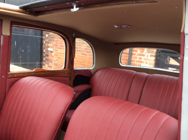

I have tried to attach a picture of the head lining in my ‘37 Saloon. Hopefully this download has been successful and you can see the finished solution.
When I bought the car some years ago most of the interior had been removed and the leather was past saving. I had the seats and door cards recovered in a more cheerful colour than the original brown and I repaired and retrimmed the sliding roof as part of the body restoration. This left a fair bit of interior to address! To have it professionally done was prohibitive cost wise, as the car’s value simply does not justify the expense. As such, it had to be a DIY job and my apologies in advance to the purists reading who may not approve of my non original approach. However, the end result is satisfactory and a lot better than having a tatty interior - or no interior, as I started with!
With nothing to use as a template, I photographed a couple of P2s at RSR events but I couldn’t get much information on the proper way to create the head lining. So the solution I decided upon for the main part of the roof was to create two panels and cover these in head lining fabric. Then fix these to the wooden bearers in the roof, in the same way that modern cars often have a panel that fixes in rather than rods etc like cars of 50s, 60s and 70s.
To make the panels I used a sheet of 4mm plywood and started by cutting the hole for the sunroof and measuring out from there. The original intention was to have a single panel but I quickly realised I couldn’t get that into the car! So it was cut just behind the hole where the wooden roof timber sits. Then it was a question of offering the panels up and shaping with a view to the rear part near the window being held tight against the roof insulation by the screws forward of it into the roof timber, thereby forcing it to curve into shape. Having made these panels, but before covering them, I set about making the panels that sit around the sides and rear window using trim board (like hardboard but more bendy from Vintage supplies). Also the bits above the doors. Another piece of ply was used to make the section above the windscreen. These bits were all covered in head lining fabric using spray glue and, once screwed into place, the roof panels were offered up and fine tuned to fit without gaps, particularly around the curve at the rear. Then they were covered and screwed into place. The bit around the sun roof was left unfinished so the fabric could be fitted into the reveal before the wood trim was refitted.
Simples! No not really. In fact of all the jobs I’ve done on both my cars, this was one of the most arduous. However, the end result is pretty good and the cost was minimal. Also, with the ability to remove the two main panels, future access to the roof mechanism is possible without major removal of the glued and wired original headlining.

- DMB 750 interior head lining view
