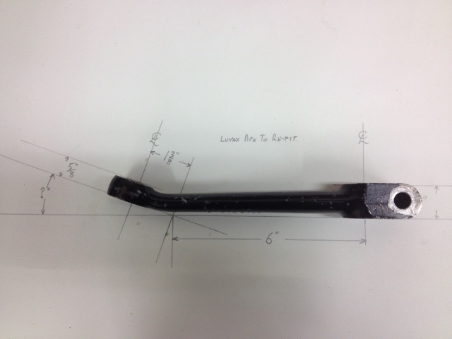

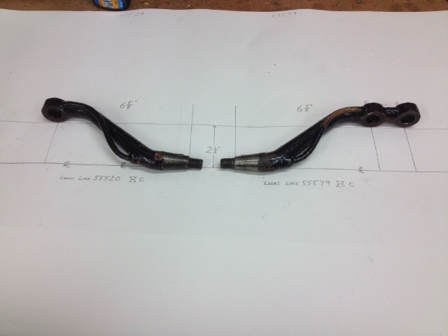

My book only goes up to 1938
That number 40461, by my book, is for 39, 37, 38. 10 and 12
My drop arm 40464 fits the 35 - 38 14 saloon and the 37 - 38 12 sports saloon.
Also if my drop arm had a bend downwards it would help with interference to the O/S spring.
Hope the pics make sense.

There's no urgency at all on this, I'll not be going anywhere soon in this present climate.
The numbers on your parts mean nothing to me, so many differences. I've been trying to sort this steering for quite a while now and my thoughts are that if the two arms were a different length, I think slightly shorter, and the drop arm shorter still by twice that amount with an offset downwards all would be good. Can't really explain it clearly enough, that's why I really want the parts with the correct numbers, if they exist?

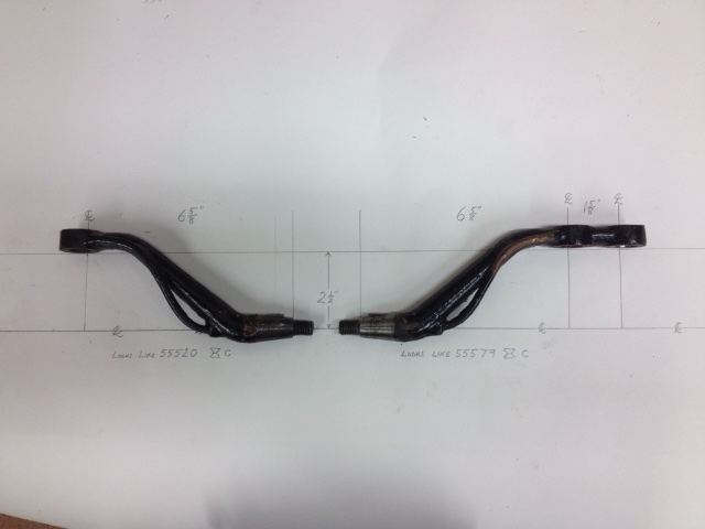

Hi Dave
A better pic showing measurements on my steering arms, didn't realise some measurements were obscured. Also all the holes for the steering joins are in the same direction ie they all sit on the top of the arms. There is a front axle from a '46. 10 on eBay showing the arms with connecting rod fixed below the arms and the drag link sitting on the top, which I'm sure would help a lot with some of the fouling of the springs on my car.

Hi Eric
Thanks for the extra pic. I've realised that I won't be able to get the arms off the stub-axles without a press so I've measured them as accurately as possible in situ. Both pairs exactly match your dimensions and the holes are tapered so that the ball joints fit on top. So the arms appear to match even if the numbers don't.
The 10hp axle on ebay is interesting because I would have assumed it was the same as a 12hp. Presumably the drag-link is meant to be curved - the 12 drag-link is straight and attachs behind the track rod and not in front as on this one. It would explain why the track levers, track rod and drag-link all have different part numbers between 10 and12.
All very fascinating in theory but maybe not much help in solving your problem!
