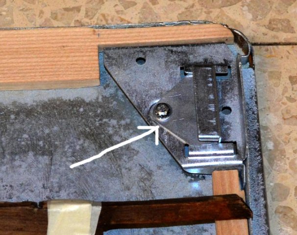

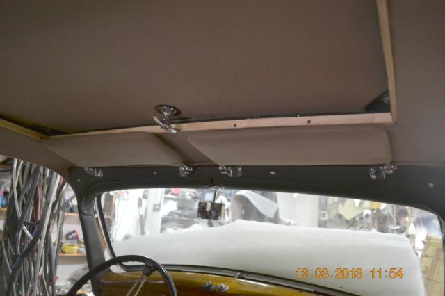

does anyone know how to remove the steel sun roof on my 39 rover 10?
Posts: 673
Re: p2 rover 10
Post by luli » Fri Feb 20, 2026 10:16 pm
Do you see the dark triangles at the front of the moving part of the roof? (usually it is covered). Move the cover aside, You will find a 2BA screws, undo them. That's all.
